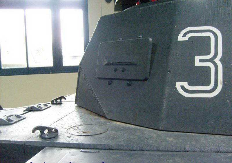

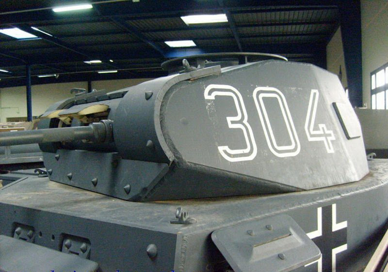

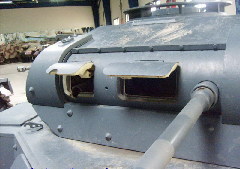

Post Re: PzKpfw. II Question
Hi Dave! I would have to say leave it as is on the front top. The side, I believe had welds but the top did not. (not sure about variants..I hope to see some more chime in here on this)
http://lh3.ggpht.com/-sxJ5R9ui8kk/T5OYd ... 252529.JPG
http://lh3.ggpht.com/-f6iSGCjpqvg/T5OYK ... 252529.JPG
http://lh6.ggpht.com/-tDNQo6GTdio/T5OYX ... 252529.JPG
Hope some of this helps a bit! ;)

Hi David
Woody and Todd have nailed it for you, riveted applique armour and welded seams else where. I looked at Toadman's tanks on Google and there is a good walk round a Pz IIC with lots of close ups of what you are after.
