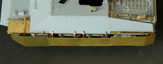

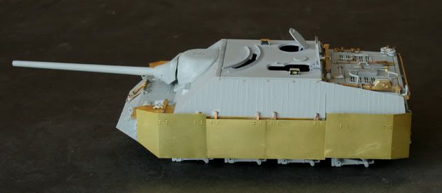

First side complete. Also note the upper rear armoured panel protecting the side of the engine deck has been dry fitted. Griffon do provide this part in brass but it doesn't have a zimmerit covering. I have used the PE mounting brackets though....

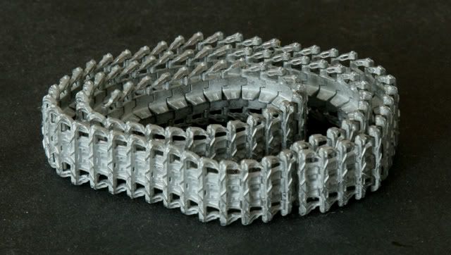

In an attempt to preserve some sanity by giving myself a break from photoetch, thought I'd turn my attention to a different type of metal - white.
For this build I'm using Fruil's ATL-28 set which depicts the required late type tracks. Shown next to the box are the first half cleaned up and cut to length 'track pins' made from the supplied brass wire....

First side done. Kit instructions show 97 links per side using the magic tracks. I've done 95 at this stage as it's far easier to add links than remove them when they are fitted around the wheels to determine the required length...

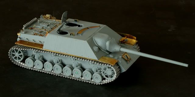

Now, I have discovered a major problem. I am embarrassed that I didn't pick up on this before but Dragon seem to have fallen asleep at the wheel with this one again :roll:
First they missed the frontal armour detail as previously mentioned, now I've discovered a return roller problem. And it's not an easy fix unfortunately - especially if you don't want to add the schurzen....
At this stage in the war, Panzer IV hulls were still being built with four return rollers. Shortly after, around October 1944, only 3 return rollers were fitted. Herein lies the problem. Dragon instructions in step one show the construction of 6 return rollers using parts D18 and 19 which are the correct pattern. I feel a bit dumb as this didn't register with me at the time and this evening, as I fitted the rollers, I suddenly panicked as I was two short :o Where were they? Had the carpet monster consumed them? A search revealed nothing. Did I actually make them? It was then things started to dawn on me. A check of the instructions and the sprue revealed parts for only 6 return rollers. Yes, there are others on the sprue, but of the wrong pattern. Yep, Dragon had got things majorly wrong :evil:
If you're not worried about accuracy or happy for the schurzen to cover up this faux pas, then you can use a different pattern roller. Otherwise you're a bit stuck if you haven't any spares.
Fortunately, Dragon's Panzer IV Ausf H Last Production kit contains the same sprue D and an unused set of these rollers so I was lucky. You have been warned ;)

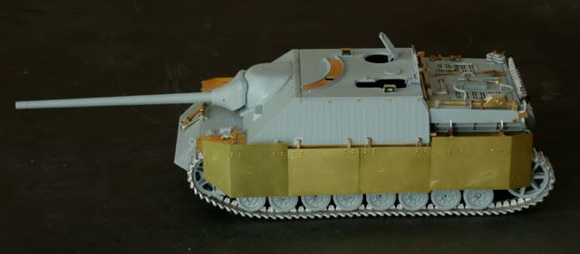

Tracks all done.....
Just need to find the enthusiasm now to get those other schurzen hangers finished :roll:
